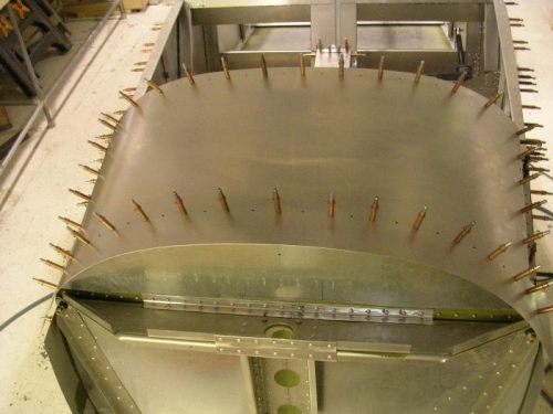

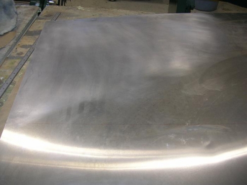

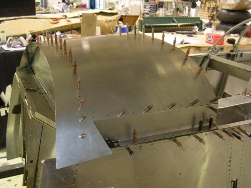

Brief Description:  601 Fuselage construction (#115)
Cut out Fwd top skin, rounded and filed edges and corners..Marked center lines and pitch distance on top off instrument panel and fwd bulk head and drilled holes to #40. Aligned top skin to instrument panel and fwd bulkhead and back drilled holes from center leading out board on R/H and L/H.Then upsized holes to #30.
