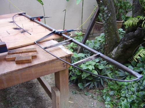

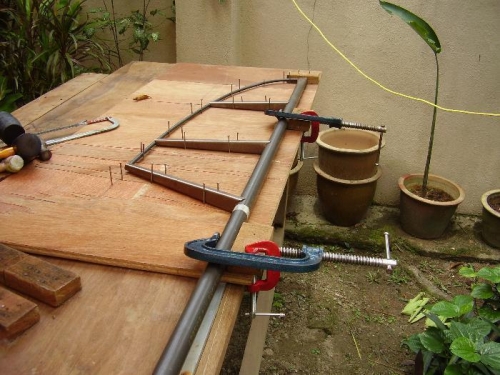

Both the leading edge tube and the trailing tube was placed in the jigs. The trailing edge end was then cut as per the plan. One end of the trailing edge was pushed in and fitted to the leading edge end. Once everything was in placed, the metal rib was then fitted. To get a symmetrical shape for both elevator side, the same jig is used.
