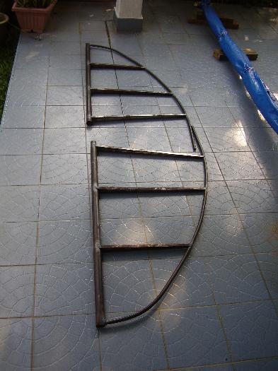

Date:  6-6-2008
Number of Hours:  4.00
Manual Reference:  Page 11
Brief Description:  Horizontal Stab Preparation (Left)
Early in the morning tack weld the rudder and 1st half of the horizontal stab. Once done, prepare the 2nd horizontal stab using the same jig and tack weld. The sliding tube of 6 x 5/8 x 0.058 is not yet fitted. This will be done after welding up all the joints.
