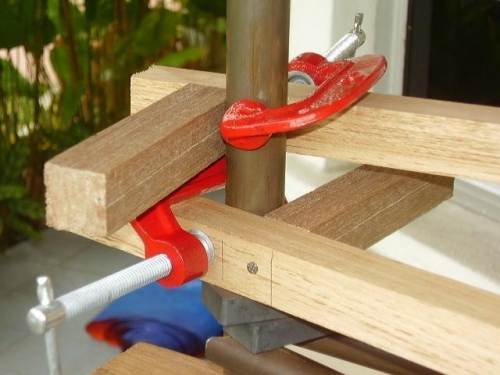

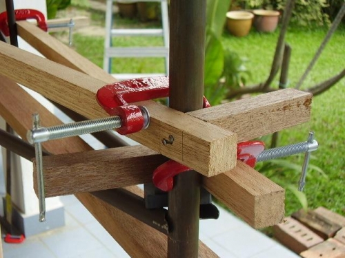

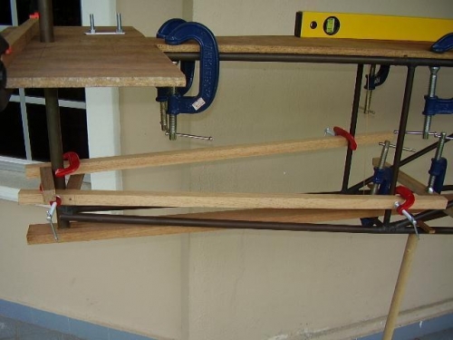

Again re alignmnet of the vertical stab and re plumbing. To ensure that the tail wheel end is correctly positioned a wooden bar was clamped to the fuselage and the the vertical stab height was adjusted.
The lower tail end of the fuselage was positioned to the vertical stab using two pieces of magnet and a wooden handle. The horizantal stab alignment was again rechecked prior to tack weld.
