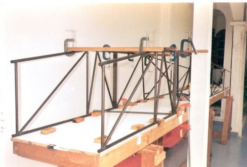

Brief Description:  Fuselage Front
Alignment of the front portion of the fuselage that will hold the engine take about 1 hr 10 minutes to make it a square. A string, plumb bob and a right angle square was used. Both the fuselage side was held firmly by clamping it to a wooden block. Once the fuselage is square, a tubing was cut and file for a proper fitting. Than a diagonal tube was cut for a fitting. Only one side was done and the other end will be completed later. It is noticed that the short tube that hold the brake handle is not in line with its pair. This will be redone once the front portion of the fuselage is ready for a tack weld.
