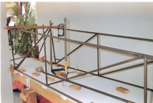

Date:  2-15-2004
Number of Hours:  2.80
Manual Reference:  page 3
Brief Description:  Cockpit Area Alignment
The upper horizontal tubing at the back of the cockpit was redone due to mismatch at the joint area. Another tubing was cut and both end was filed for a good fitting. At took quite a while for a fitting. Once completed the horizontal tubing was clamped with a wooden block. The vertical tube at the back of the fuselage (back seat), after proper fitting, was clamped with a wooden block. The diagonal tubing at the aft of the cockpit need further clamping to secure it properly. There is also a need to clamp the horizontal tube at the front of the cockpit supporting the undercarriage for a good fitting. AFTER TODAY, THE TUBE IS READY FOR A TACK WELD.
