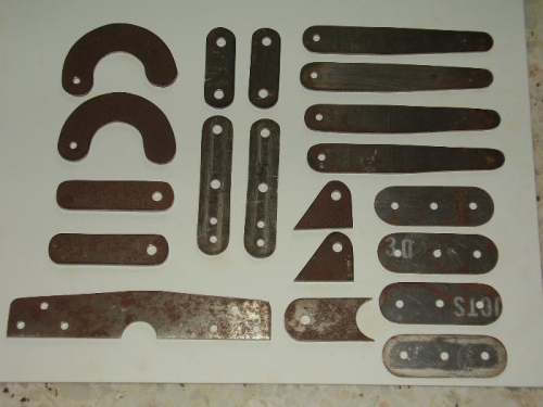

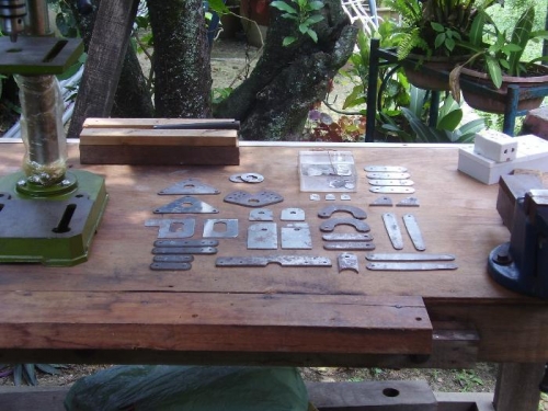

Today drilled holes on all the misc items. Pilot holes were first drilled followed by the actual hole sizing as per plan. The items which are in pair are drilled together in order to get the same drill position. Shaping the edges of the pair item will again be done to ensure the same shape. The holes was then drilled using either 3/16" drill bit or 1/4" drill bit.The 3/4 " holes are yet to be drill.
