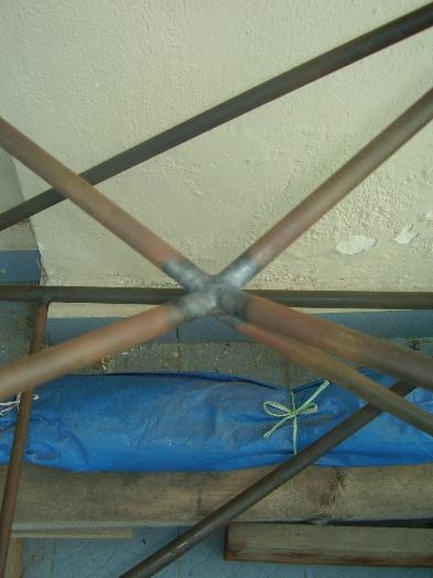

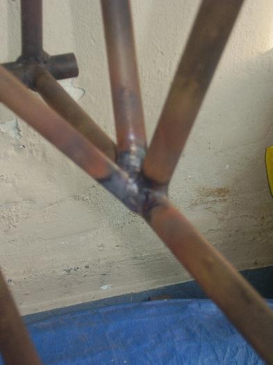

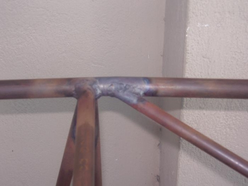

Welded the fuel tank support. The four jointed tubing was welded first to ensure that it is rigid and followed by the other four ends to the fuselage. The bracing was welded last.
