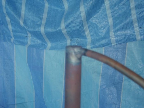

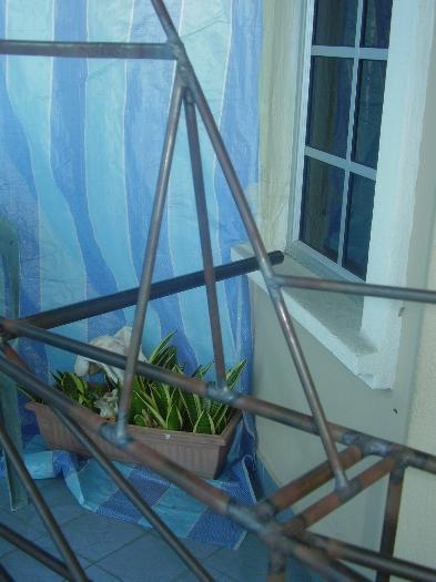

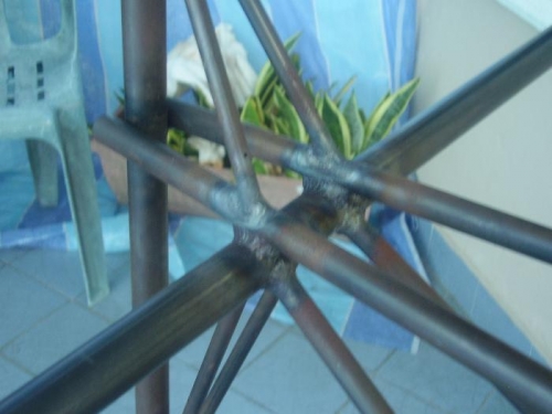

Welded the horizontal stab tubing to the aircraft frame. Due to its positioning it is difficult to weld. Again it require to heated up a large portion of the tubing area and a hotter flame to able to get a good weld. The upper bracing for the tail vertical tubing was then welded followed by welding the vertical stab leading edge to the frame and vertical tubing, its bracing and its metal ribs.
