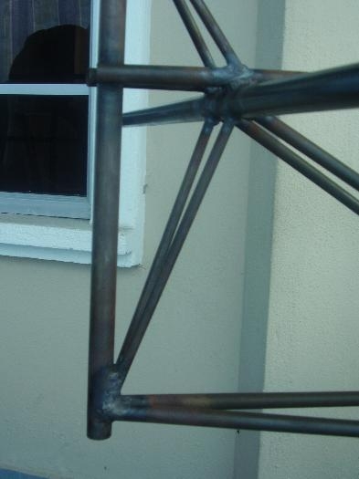

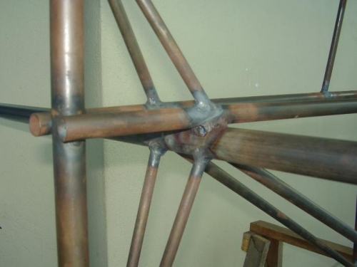

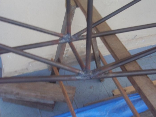

Tail area
Managed to weld the side diagonal at the tail end as well as the lower vertical tube bracing. Welding to the horizontal stab tubing take a while due to the double layer of the tubing. Had to heated up the area really well and use hotter flame.
