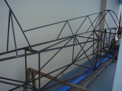

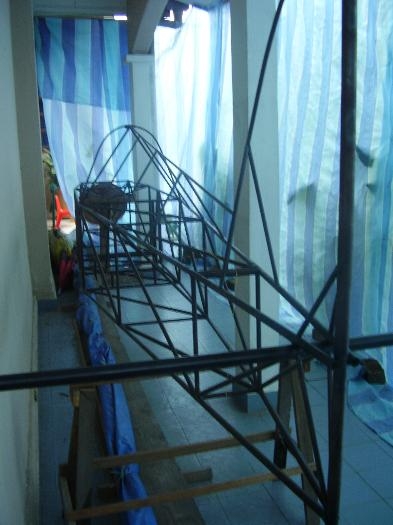

Tack weld - turtle deck bracing
Tack welded all the turtle deck bracing. One of the vertical stab bracing did not fit nicely. Re- shaped by filing the top end and then tack weld. Drilled blow holes on the tacked tubing before welding start.
