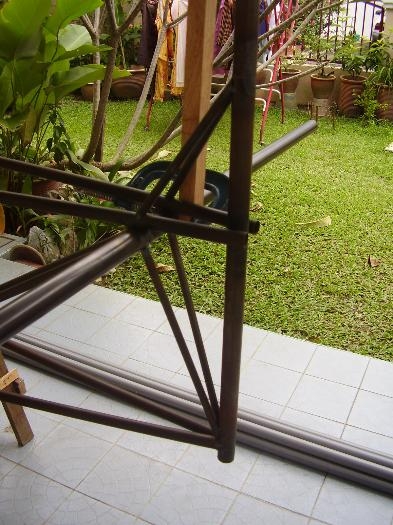

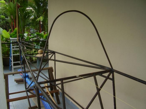

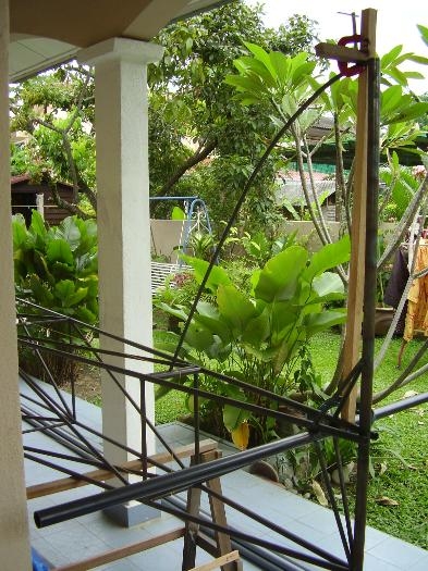

Brief Description:  Tail Longeron and Vertical Stab
Tacked weld the longeron holding the horizontal tube and the vertical tube was heated up to correct the bow due to the tack weld. The leading edge of the vertical stab was then put in place and to tack weld later. It has started to rain again. Earlier the front bow for the turtle deck was aslo tack welded.
