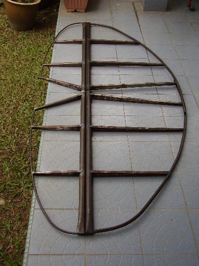

Continued with the fitting of the elevator metal ribs today. The elevator was then placed together with both left and right stabilisor and found the middle metal rib of the stabilisor is not in line with the middle rib of the elevator. The tack weld of the stabilisor metal rib was cut, realign and re tack. Also done was the fitting of the short metal tube 61/8 x5/8x0.035 to the upper end of the leading edge of the stabilisor.
