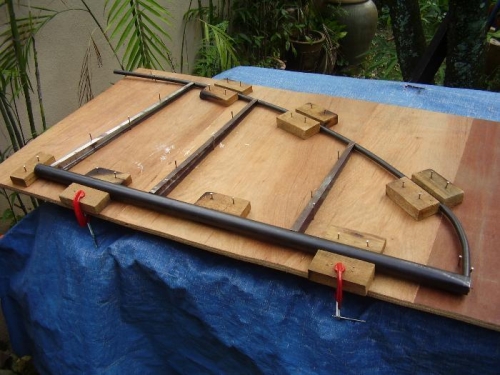

Date:  6-5-2008
Number of Hours:  3.50
Manual Reference:  Page 11
Brief Description:  Horizontal stab preparation (Right)

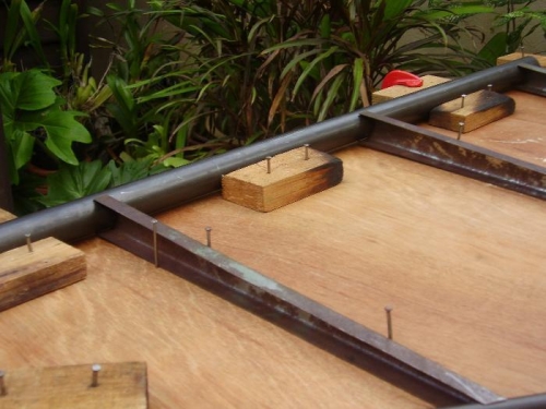

Use wooden block to hold the leading edge and horizontal tube. Measurement done between the leadind edge and horizontal tube to ensure correct spacing. The end of the metal ribs are shaped accordingly and fitted to both tubes. Managed to complete one side only due to afternoon thunder storm. Ready for tack weld hopefully the weather is better tomorrow.
