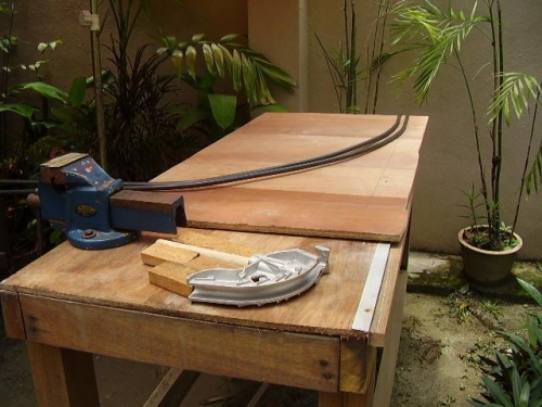

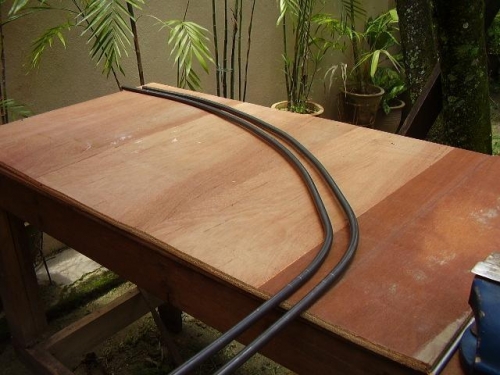

Brief Description:  Horizontal Stabiliser
Forming the horizontal stabiliser leading edge - left and right - using the tube bender. Took a while to match the two sides. Final touches will be done once the ribs metal sheet attach to the tubes.
Measured and cut the 1 1/8 x 0.035 tube in two parts ie 36" each.
