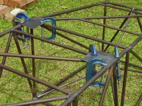

Jig Gear Bushing
A jig was made of sheet metal to drill a hole for the landing gear bushing. The bushing postion is located than drilled (5/16 ") and file. The hole need to be further refine since the bushing size is 7/16 " OD x 5/16 " ID.
