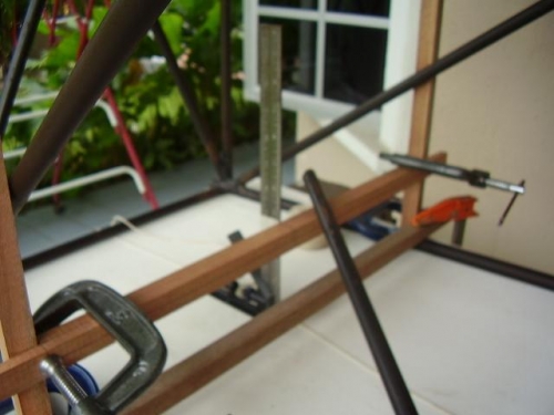

Brief Description:  Fuel Tank Support
Final adjusment of the wooden bar. A tube was cut and matched with the centre point on the wood. The other end of the tube was located about one inches from the joint at the firewall. This is to ensure for a clean weld. Another tube was than cut. The end at the centre point was than filed so the both tube fit each other.
