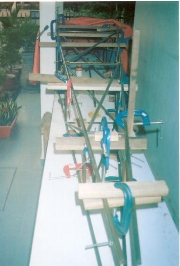

Date:  6-1-2004
Number of Hours:  3.80
Manual Reference:  page 3
Brief Description:  Fuselage Tail Area
Readjusting the top diagonal at sta 115 3/8 so that the horizontal tube is straight. The diagonal end was slowly trimmed until the horizontal tube pair fit nicely. It seemed that the horizontal tube was slightly off from the straight line but after re checking , adjusting and eye balling it did not seem "OK". A wooden block was positioned to hold the horizontal tube (table top) firmly that connect sta 73 3/8 and 115 3/8. A short tube was cut and trim at sta 156, it fits nicely. A wooden block was used to firm up its position. The short tube at sta 154 3/8, after adjustment it seemed there is a gap. To check again before starting a tack weld. " IF ALL GOES WELL, THE TUBES WILL BE TACK WELD"
