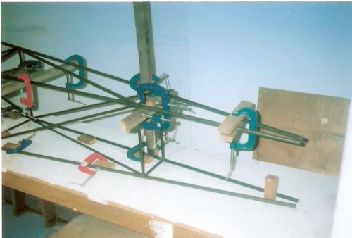

Date:  5-28-2004
Number of Hours:  5.90
Manual Reference:  page 3
Brief Description:  Fuselage Tail Area
It take 2 1/2 hrs to adjust for a good fitting all diagonals and horizontal tube at sta 154 3/8 and 115 3/8. A number of C clamps are used to hold all the metal tubes. A diagonal tube (table top) was then cut to fit for location between sta 73 3/8 and 115 3/8. Both end was trimmed and it fit quite well. However, fitting all the diagonals again became a problem once one end of the horizontal tube is loosen up to fit the diagonal between sta 73 3/8 and 115 3/8. Adjustment was again done but not satisfactory. Will do again.
