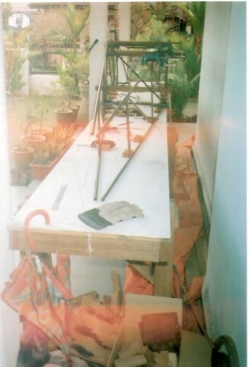

Date:  3-21-2004
Number of Hours:  4.80
Manual Reference:  page 3
Brief Description:  Alignment of the tail area
Notice that a tack weld at the front vertical tube Sta 0 with the horizontal tube for the front floor broke. It required to be readjust and retack. Alignment for the tail area was very difficult. Squaring the middle tail with the use of string and square takes quite a while. The same was also done for the aft tail end. However, this may require further alignment. (2 hrs 50 min). Once the middle tail area looks ok Sta 11 3/8 a horizontal tubing was cut for the upper and lower portion. Next a horizontal tubing for the aft tail end Sta 14 3/8 was cut and trimmed. Trimming is not completed due to weather (raining). Rechecking the alignment again. There was a concern that the middle tail area Sta 11 3/8 is not properly squared. To recheck again and again.
