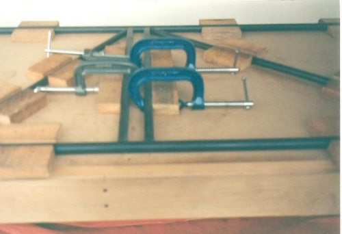

Brief Description:  Square tubing fitting
