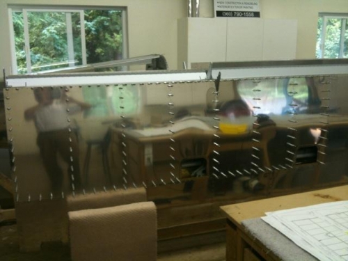

Bottom skins
Clecoed the bottom skins on both wings and drilled using a #40 bit. Also cleaned up. Drilled and dimpled the inspection covers as well as dimpled the nut plates.
