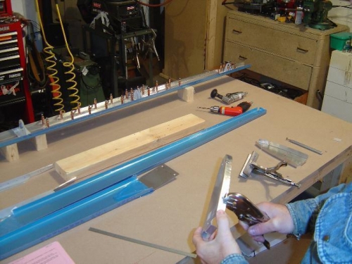

Brief Description:  Horizontal Stab Rib Preparation
Worked on inboard ribs for HS(HS404/405). Trimmed for front spar reinforcements and deburred and fluted. Also deburred and flutted the other HS ribs. Had to bend the flanges to 90 degrees on each rib and then flute so the web is flat as possible - trial and error. Printed some good guidance off of Vansairforce.net.
Notching our ribs for front spar reinforcements
Deburring nose ribs on 3M wheel
Fluting nose ribs
Fluting nose ribs
