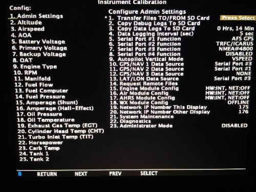

Brief Description:  Programming the AFS3500EE EFIS
Took the time this morning to dig into the AFS3500EE manual - it's my primary EFIS and engine monitor, and calibrate some items and do some programming. Some of the programming happens on the home computer tonight and uploads via SD card, such as the checklists and maintenance data.
The capability of this much older generation box blows me away. I can't image what the latests stuff does! I can't list them all!
-Calibrated the elevator trim
-Reset the fuel amount - tank probes haven't been calibrated yet.
-Turned off the fuel press alarm - just until my new sending unit comes in.

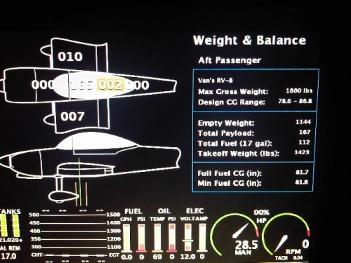

-programmed the weight and balance - it lets you compute your w/b right on the screen super fast and easy!
-programmed my airspeeds
-checked my software version
w/b page. The yellow lines near the gear leg are the c/g limits. White line is current cg!

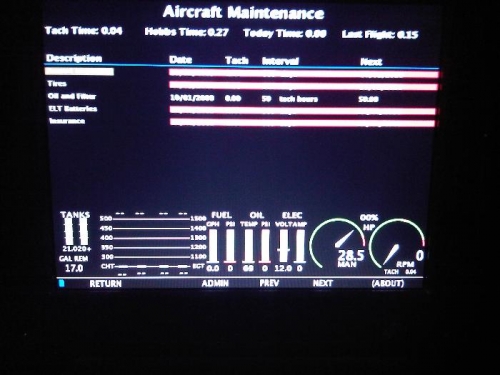

Maintenance page tracks all this stuff
All the administrative stuff you can play with.
