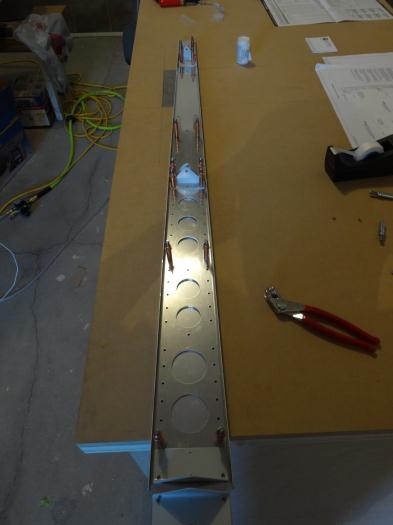

VS - 808PP had a heavy curve in it due to manufacturing process. Straightened it out by lightly pressing it agains the table. Got it about 97% straight. Went to cleco everything together in step 2 and couldn't because holes hinge brackets were too small, so i pre-drilled them on the bench drill then clecoed them. Used #30 reamer to ream out all the holes in step #3.. In step #4 match drilled 2 holes in the upper hinge bracket, then reamed it out ewith # 30 reamer. Located all the rib flanges, and radiused corners in the forward end of the VS-706 tip rib and VS-705 nose rib. Started fluting the ribs
