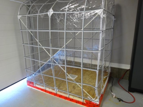

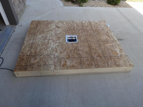

Brief Description:  Building paint booth
After months of thinking of how to solve the priming problem I came up with the solution. For $130 i bought small greenhouse. Built a platform and installed a 70 CFM bathroom fan in it. Tuck tapped the greenhouse to the platform. Creates enough vacuum to start collapsing the green house. Will try it out later for actual priming
