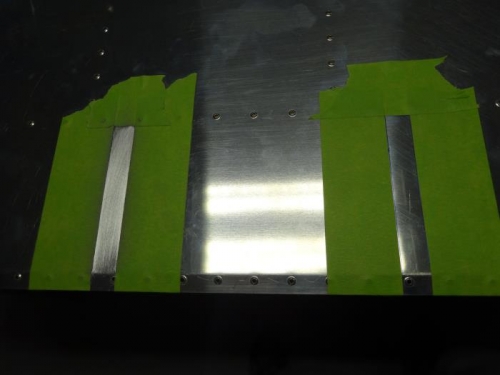

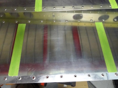

Brief Description:  Step #1-2 Sanding Right Skins
Set up and sand both right skins. Started by masking around the areas to be sanded down, then using 150 grit al oxode paper sanded untill all shine was gone, cleaned the area removed masking tape and tape the area that was just sanded. Woked out very well.
Sanded on left
Sanded on left
Masking sanded area
Masking sanded area
