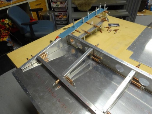

Brief Description:  Steps #1 - 6 Drilling and assembling Left Elevator

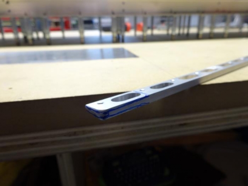

Did all steps on the page. Drilled all required holes without any problems. Marked trailing edge to match the thickness of the fairing, then used bench grinder to reduce profile. Worked out about 7/10 because it was hard to make it smooth with grinder, other side will try to do it with file. Also did Steps #1 and 2 on Page 09-09.
Attached tip rib assembly
Marked Trailing Edge
Trailing edge with reduced profile
