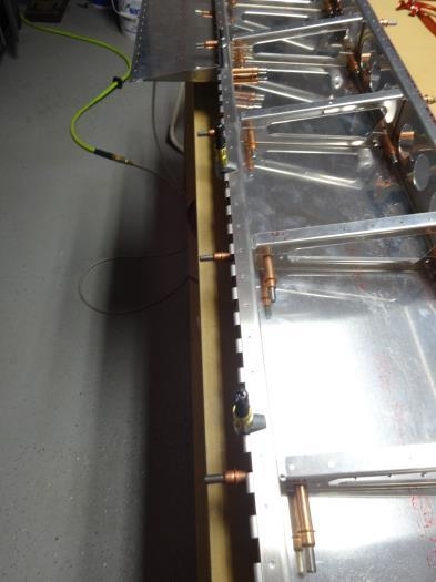

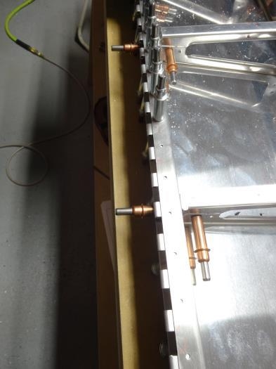

Brief Description:  Step #1-3 Trim tab hinge drilling
Marked the line on the entire length of the hinge, clamped it into place so the line is in the middle of all holes and started drilling with #40 drill. Clecoed as I went. Trimed the end of the hinge and cleaned it with the file
Clamped into place

Clecoe as I drill
Clecoe as I drill
