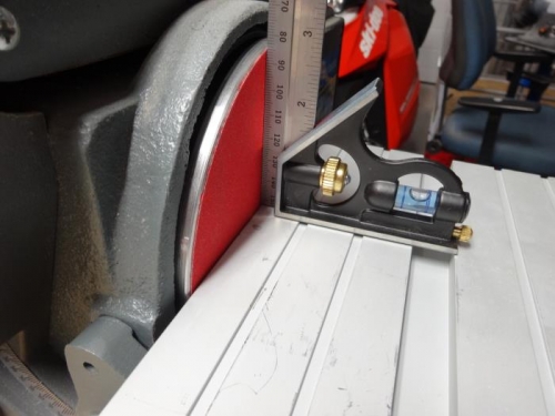

Brief Description:  Step #1 Sanding PVC blocks
Made surre that plate is sitting 90 deg to the sanding disc. Sanded 7 blocks, had to be very carefull when sanding since it didn't take much effort to take too much material off. Sharp edges did with the knife and finished with hand sanding block. Worked out very good.
