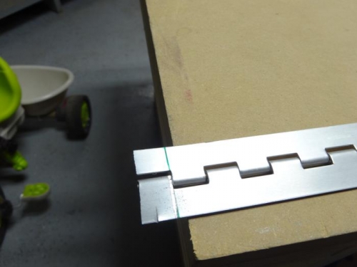

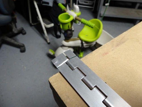

Brief Description:  Step #4-5 Trim tab hinge

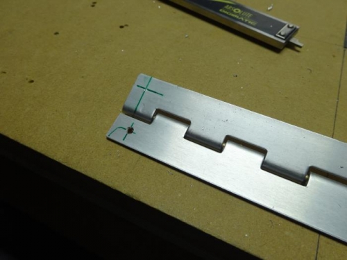

Raw piece of hinge started on the wrong tab. Tried to trim it with sheers without sucess because material is too thick.Trimmed 0.5' if hack saw, had difficulty cutting the middle rod, very hard material. Marked lines as per drawing, center punched the holes and drilled them on the drill press
Before trimming
Before trimming
