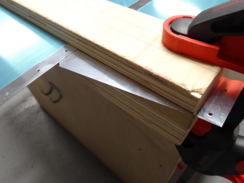

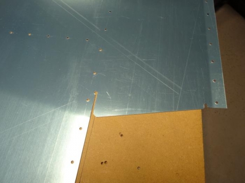

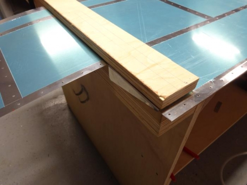

Removed vinyl from inside of the skin, Cut the vinyl on the outside with the hot knife. Debured all holes and edges. Used sharpie to mark the bend line. Bent the tab as per Step#2 on the 09-04 page
Skin out of the box
Tab just before bending
Bent tab
