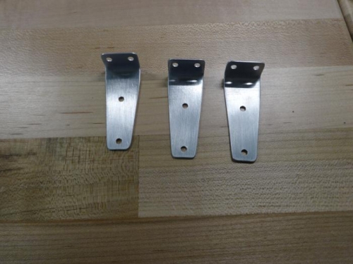

Brief Description:  Step #3 Separating Shear clips
Marked the cut lines, then using mini table saw separated between the lines. Then using cut and polish wheen removed hatched areas. Its was hard to use C/P wheel because parts were small and thick and were heating up very quick. had to alternate between the parts to let them cool down.
Shear clips
Shear clips
