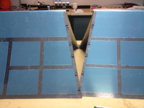

Finished deburring all holes on skin #2. Set up skins side by side to make sure that I dont make mistake in marking left and right skins. Marked empennage fairing and tip fairing screw holeson both skins.Set up DRDT-2 on the bench and started dimpling skin #1, working my way around the edge then in the middle of the skins. Every so often checked the reflection to make sure dies are set up properly.Finished dimpling 1 skin.
Marked skins
Marked skins
