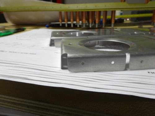

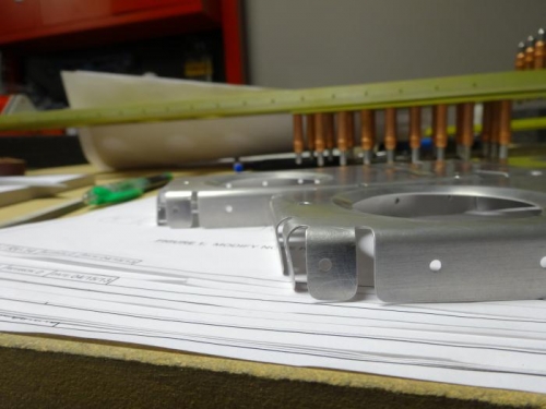

Step #2 and #3 Modifying Ribs
Opened aft flange on the 2 - HS-905 Nose ribs by 10 deg using hand seamer. Also, opened aft flange on the 2 - HS - 1004 Inspar ribs by 10 deg. On the same inspar ribs bent forward flange by 12.5 deg, and made 2.5 deg bend between forward notches.
Modified forward flanges
Modified rear flanges
