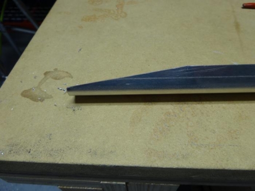

Date:  10-18-2014
Number of Hours:  3.50
Manual Reference:  08-03
Brief Description:  Step #4 Trimming spar cap and stringer
Marked stringers x 2 (HS-00914) and spar caps x 2 (HS-00913) with marker between 2 notches. Used hack saw to cut 1/8" away from the line, then used vixen file to shave off the material up to the line. This worked very well. Used file for coarse material removal during deburring and finished deburrig on the soft bench wheel.
Stringer before trim
Stringer after trim
Stringer after trim
