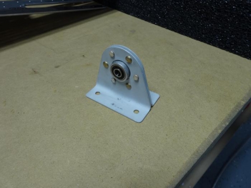

Brief Description:  Step #2 Riveting inboard hinge brackets
Clecoed every other hole in the bracket and clamped assembly to the worktable. Squeezed open holes with AN470AD4-6 rivets. Then moved clecoes to the other side and sqeezed other 3 holes. All rivets are up to spec.
Squeezing the braket
Finished hinge braket
