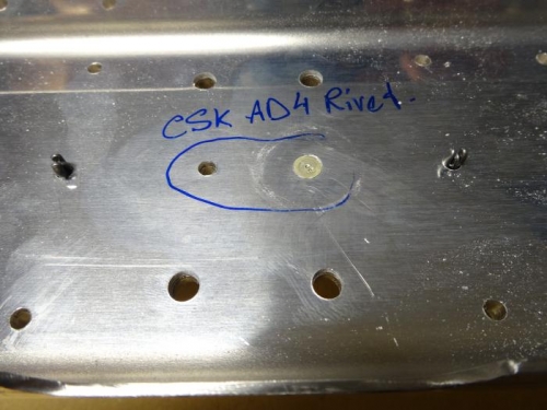

Brief Description:  Step #5-6 Csk and drilling holes
Csk 2 holes on the Spar as per drawing. Before Csk backed out cage 10 clicks to make sure, and it hapened to be exact setting (very lucky that I made that descision). Backed out 1 click for the second hole, and the rivet was sitting too high. Backed in 1 click and finished csk. Final drilled 4 holes around csk holes with #12 reamer
CSK hole
CSK hole
Both holes csk
Both holes csk
