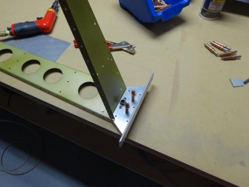

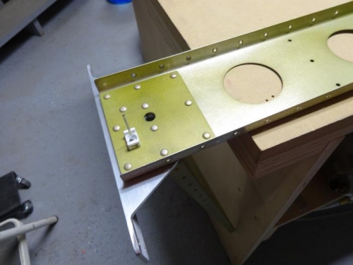

Brief Description:  Step #3-4 Riveting R-606 PP doubler
Primed a batch of parts for the rudder. This times used a filter on the vent and new can of primer and echieved very good results. (1 hr) Waited few hours and clecoed R-606PP parts together. Used rivet sqeezer for most rivets. Had to remove one rivet because it bent over, no problems removing it. Rivets 8 length had to use rivet gun because sqeezer couldn't do it. Used double sided tape to rivet tie wrap clip into place.
