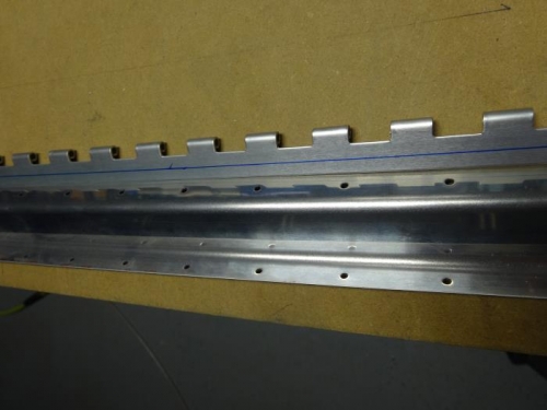

Brief Description:  Step #4-6 Trim tab hinge drilling
Marked the line on the aft half of the hinge. Clamped it to the E-01405 trim tab spar and drilled it with #40 drill.Clecoed as I went. Attached it to the elevator to see if didn't bind. Works very smooth.
