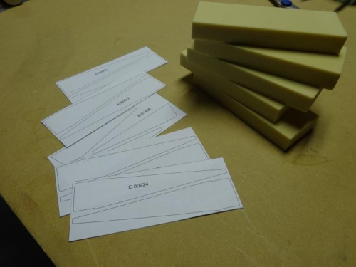

Made sure templates are correct size. Cut the templates and glue them with spray glue to PVC blocks. Waited 1 hour and cut them with hack saw. Will sand them to size when I will get belt sander from dads
Templates and PVC blocks

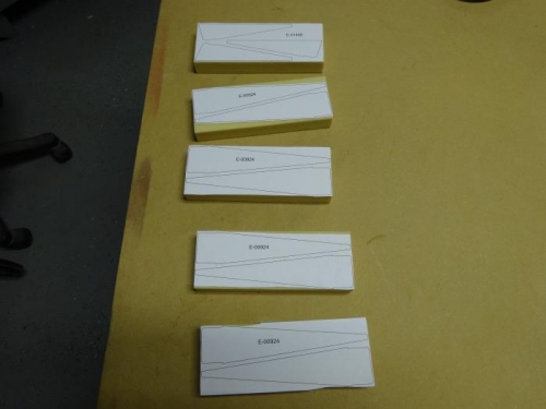

Glued into place

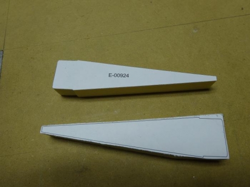

After cutting with the saw
