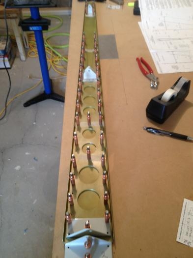

Step 6 Set Rivets VS -410PP
Dimpled the ribs on VS-803PP using reduced female die. Then clecoed everything together. Started with riveting VS-410 PP. Rivets were slightly too long but set good. One rivet close to flange of VS-410 PP sliped and will need to be replaced.

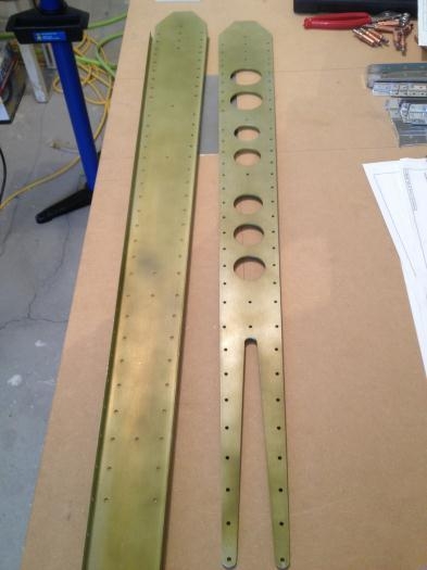

Primed Rear Spar
Assembled Rear spar
