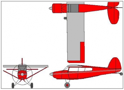

- Will paint fuselage red with two 1” white strips and polished wings
