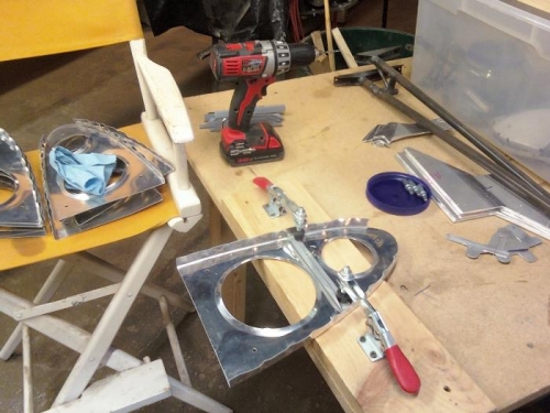

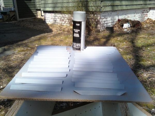

Brief Description:  Prepped and painted 30 nose rib stiffeners.
Prepped and painted 30 nose rib stiffeners. I will only be paint the stiffeners and wing skin, the ribs will be left with only the alclad coating. Cleaned bees wax of nose ribs with lacquer thinner. Matched drilled 20 nose ribs and stiffeners. Deburred 15 sets. 10 more sets to drill and 15 more to debur.
