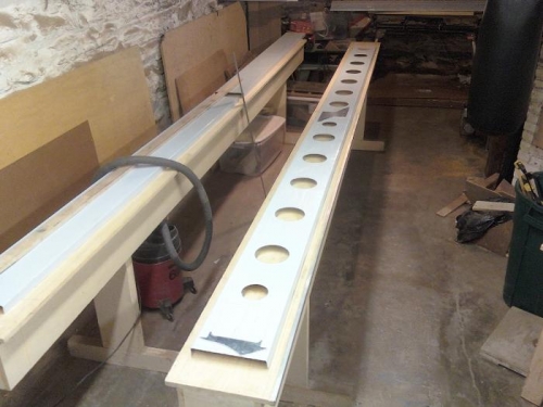

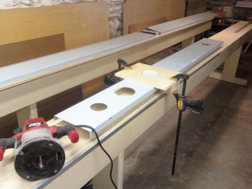

Date:  3-27-2010
Number of Hours:  8.50
Brief Description:  Laid out left and right main spars.
Laid out left and right main spars. Trimmed main spars to size. Center drilled main spars attachment points. Center drilled and filed to size 2 of the 4 inside main spar attach plates. Center drilled and filed to size 1 of the 4 main spar splice plates. Routed out right main spar lightening holes.
