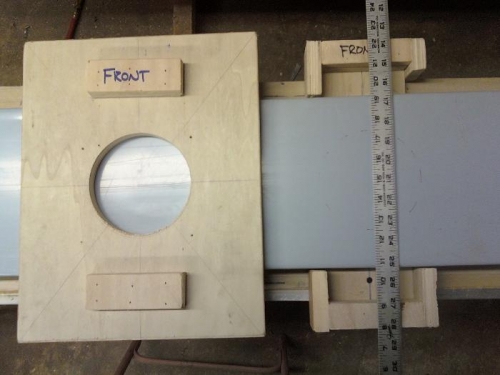

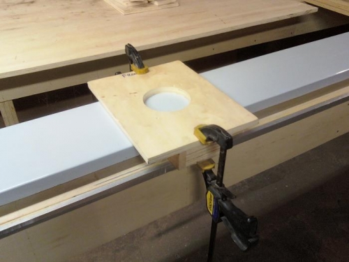

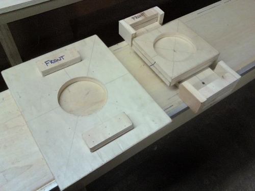

Made jig to route 5” lightening holes in main spar
Made jig to route 5” lightening holes in main spar. I will reuse the jig base for to the rear spar and aileron spar jig.
Hole is 5" and centered
Base is temporarily screwed top bench
