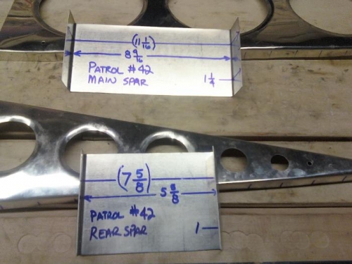

Brief Description:  Finalized main and rear spar bend dimensions.
Finalized main and rear spar bend dimensions. My homebuilt brake continues to work well. I will have to do some handwork on the rear spar to get the extra bend past 90 degrees. This may cause a little waviness from the hammer stokes, but should not effect the airworthiness of the part.
