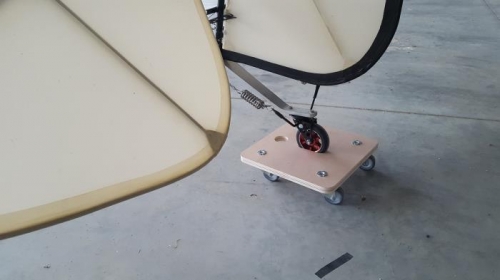

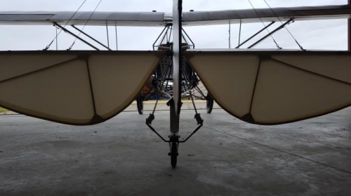

Brief Description:  Repaired tailwheel & dolly.
New tailwheel in place.
As it is not full castering and to make maneuvering the LE about the hangar easier, I bought a 4 x caster dolly and machined a slot for the tailwheel to sit in. This is a must do item and makes pushing the aircraft back into the hangar a breeze.
