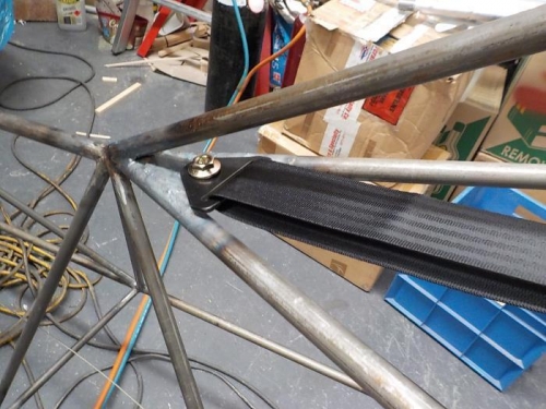

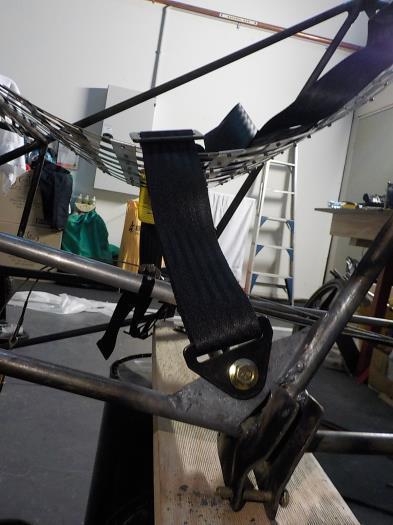

Brief Description:  Seatbelt mounts
Prior to welding the mount points to the fuselage I drilled the bolt hole to the thread size which still allows the black metal webbing mount to rotate freely.
The rear mount is 1/16" plate welded to the cluster. Will need to cut the rear seatbelt webbing and have it re-sewn shorter.
