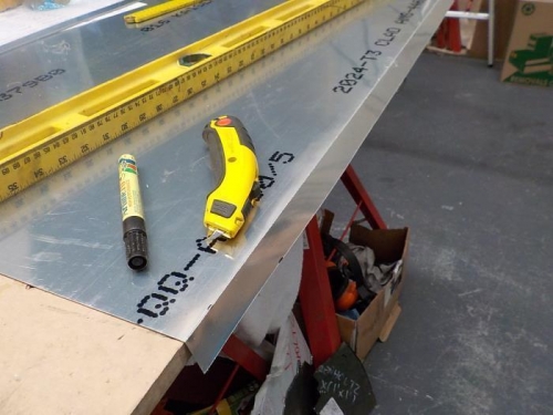

Sept 26, 2016
I had planned to use a guillotine on the .016" aluminium to get a nice line. Tried the score and snap method which worked really well then just sanded the edges off.

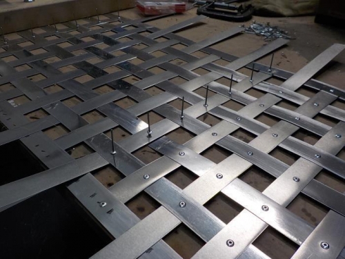

The 8 long lengths were clamped under a piece of timber onto the workbench. The outer 2 were marked in 1" increments and the 14 cross pieces interwoven. I left overhanging ones where they needed to be folded over to avoid having a sharp edge facing upwards which would catch on things. Drilled through and into the workbench before placing and pulling 1/16" grip rivets.
Looks like a Legal Eagle seat and extremely light.

Score and snap
Score and snap
Weave
Weave
